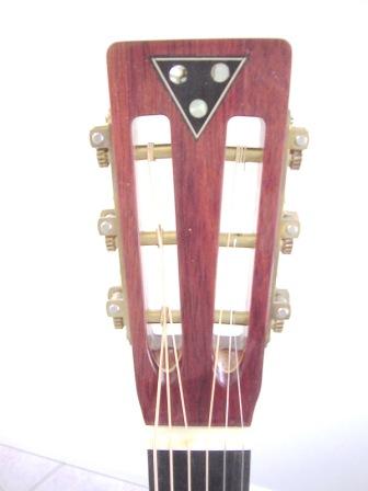

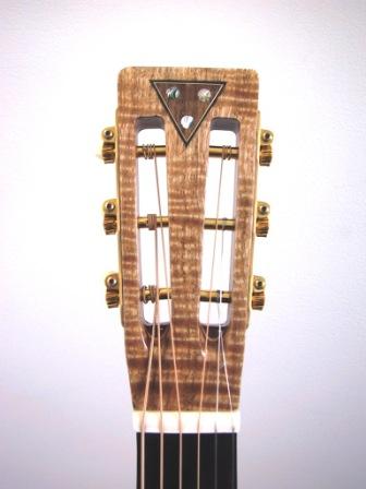

John...Here are the parlor twins showing results from the Luthier tool jig.

JJ that is nice
Now I notice that those corners are a little squared off, which I also like. what kind of router and template follower and bit size did you use on this, if you don't mind my asking
PostPosted: Tue Sep 20, 2005 1:07 am
John...I'm on the road right now and can't remember all of the details. I used a PC router. I followed the manufacturer's recommendations...I think it was a 1/4" spiral bit with a ??" template follower. I'll let you know that dimension when I get back home. Perhaps Hank has the instructions handy.
